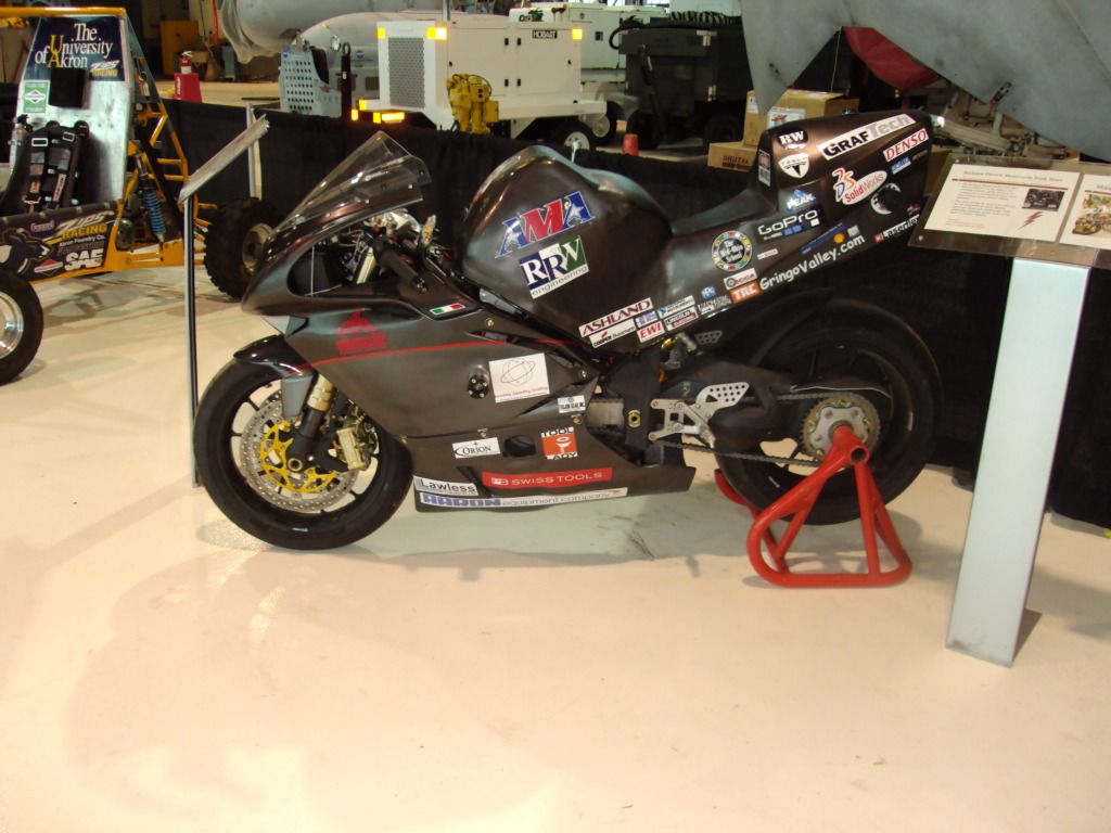

    I have slyly mentioned this in passing and to some other members, but I am the Technical Team Lead of the Buckeye Electric Motorcycle Race Team at The Ohio State University. Our team was founded 2 years ago by myself and Sean Ewing with the help of our founding sponsors Lawless Industries and Aaron Equipment. In our first year RW1, our first machine, was created due in large part to Sean. We set an ECTA (East Coast Timing Association) electric motorcycle speed record of 112.349mph. This second year myself and other new teams leads took over and attempted to refine RW1 and compete in the 2012 season. This initially involved finding a limiting issue in our controller, replacing a dying cell, getting familiar with the machine and restructuring the team. If only it was that simple.

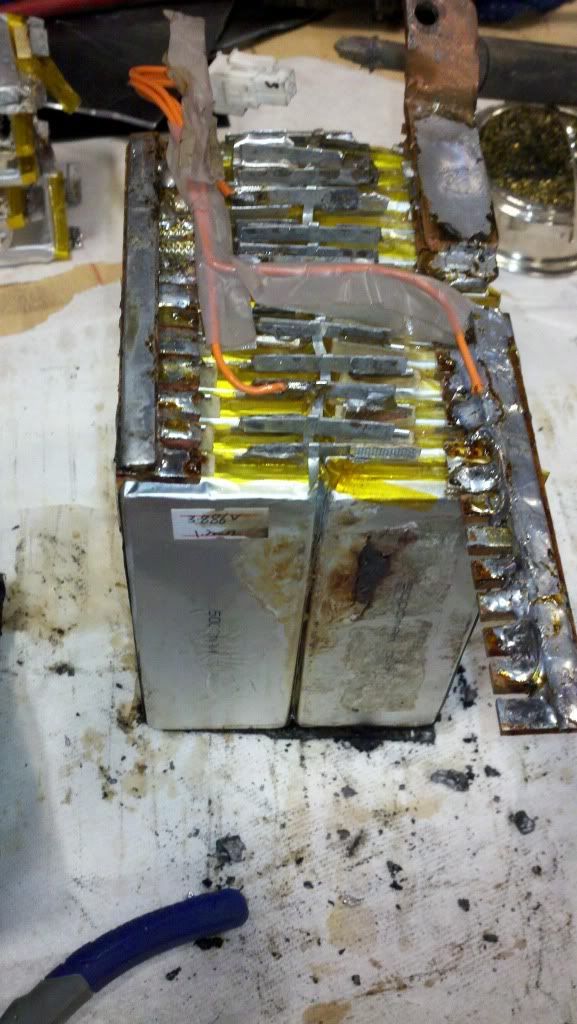

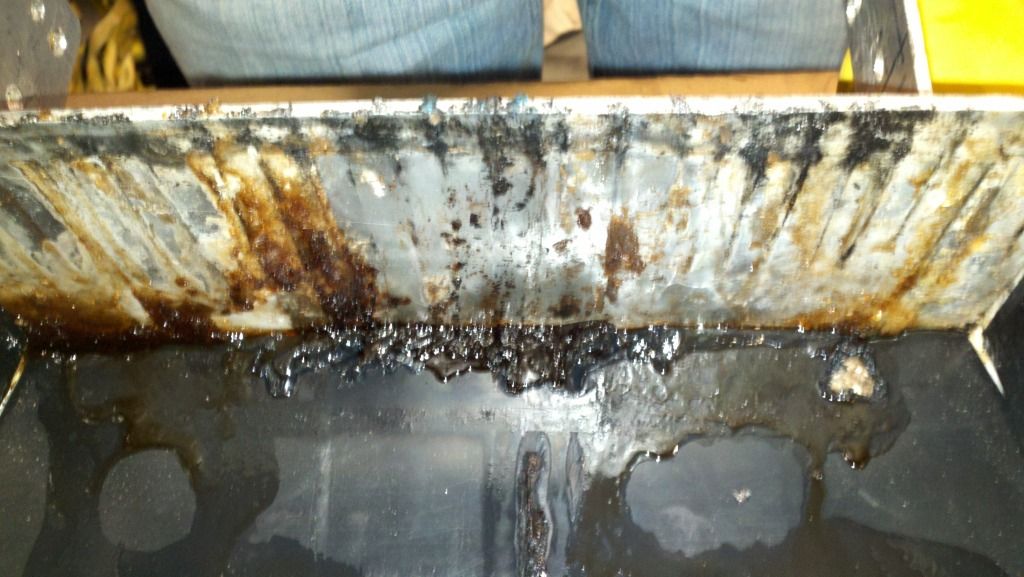

    Through the winter we stripped the bike down to trim some fat from the aluminum battery boxes. During this process we actually found electrolyte inside one of the battery boxes. Here is what the box looked like. That is aluminum and abs material
    We were unable to determine which cell had failed and ended up removing the entire 8s subgroup because the electrolyte actually started to eat away both the external clear coat and aluminum pouch of multiple battery cells. This was the beginning of our battery issues, I’ll illustrate the rest of the year later.

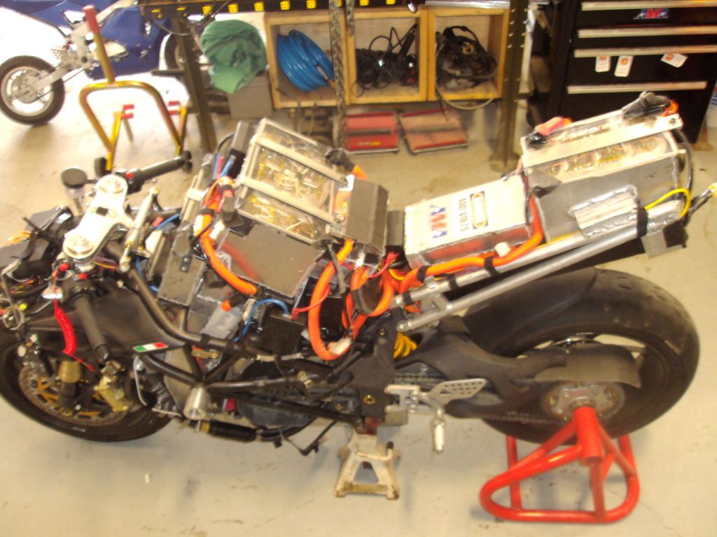

    RW1 specs
    -5Ah 25C Blue Lipo Cells; 112s7p; 415V, 35Ah ; 14.5kWh nominally
    -Remy HVH250 motor; stock casing; 110lbs
    -Tritium Wavesculptor 200; 20lbs
    -In house build ADC based BMS; manual RC charger balancing
    -~620lbs
    -~110HP (@ wheel, dyno’d)
    -2007 MV Agusta F4 1000R chassis; forged aluminum rims (6lb front, 7lb rear)
